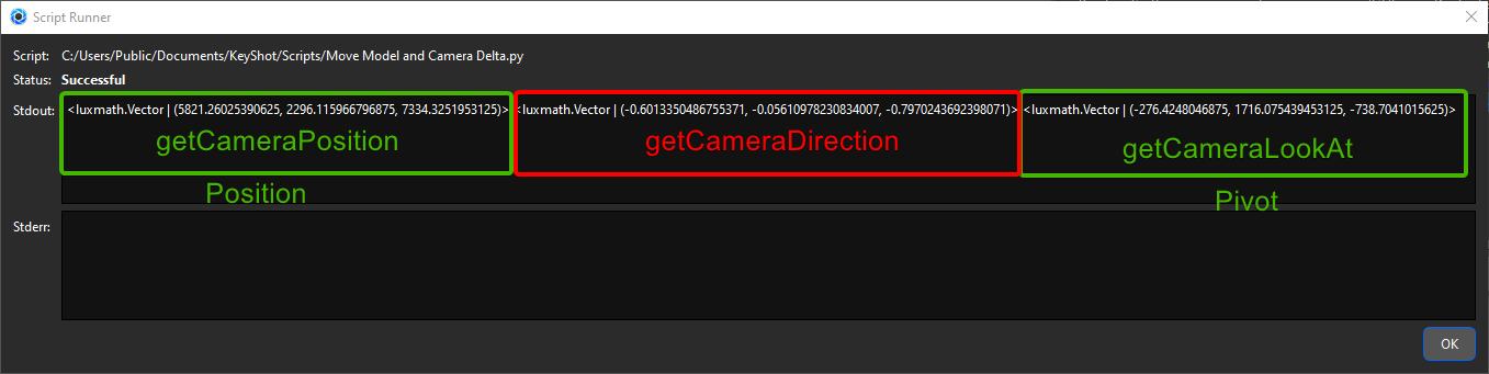

I’m trying to find the right method for camera_target, getCameraDirection and getCameraDistance dont seem to be the right ones.
For example:
imagem
I can only find 2 of the methods that return the values I’m looking for.
Can someone help me please?

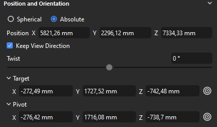

You have to toggle off the keep view direction option

The Camera direction vector is normalized and gives the vector relative to the camera. For that reason it is not matching what you see in the UI.
You can get the original value if you take the camera direction vector and multiply it with the camera Distance. Then you should get the direction vector relative to the camera postion.
You can then add that vector to the absolute camera Position vector you already have.
The result should be the absolute camera target vector.

in most cases i would expect the Pivot and target to be the same when working with scripting, but i can see that this might not always be the case.
Yes, this definitely an edge case. It was completely unintended though, and there’s no real consequence to my current project if I keep Target and Pivot the same as the old camera’s configuration. It was just the consequence of manually fiddling with the camera until I got a satisfactory result.

Yeah these are the values I get for the Target, thank you!
Now my only real question is: “How do I get to set the Target to be a different value from the Pivot?”
Before your reply, I was able to figure out that the target was related to cameraDistance and cameraDirection and thought that maybe if I made sure that those two attributes were the same then the Target would be different from the Pivot.
I was able to move the camera and model successfully but even after trying setCameraDistance and setCameraDirection to the previous camera’s values (even though they didn’t change) the Target and Pivot remained the same.

Usually the way you can end up with missmatched Pivot and Target is when using the “Pan” camera Navigation method. Though i am not entirely certain that there are no other ways to end up in that situation.
You may have noticed that after using “pan” the camera will no longer rotate around the Lookat Point.
If that is undesired you can prevent it by enabling “Use Target as Pivot” in the cameras Position and Orientation settings.
